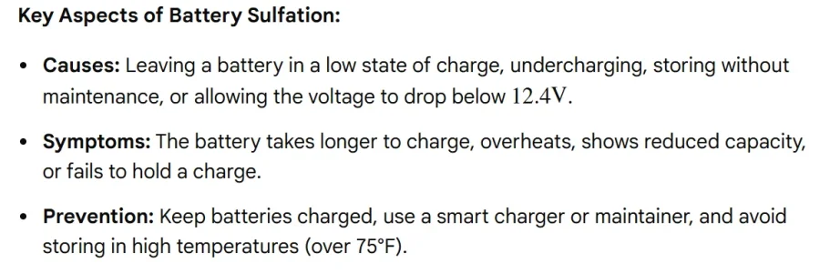

In the application of it being used (a EV 12v auxillary powe source) 2 years lifespan is not a big surprise.
The problem is this type of battery does not like being kept at under 12.5 volts, which if you monitor the MG app when the car is parked up you will often see a resting voltage of 12.5-12.4v
This causes the plates of the battery to sulphate and reduce lifespan...
The answer is to replace battery with a higher quality brand (such as Yuasa) and/or higher capacity.
Another option on a EV, is to replace lead acid with a LIFEPO4 battery, expensive but should last many years.
