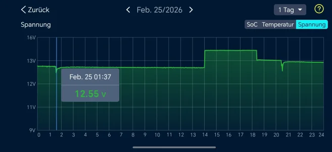

The app's display is not particularly accurate. As soon as you query the car via the app, the voltage drops slightly. Some control units are activated and even the interior lighting comes on. That's why the app shows you the low voltage.
I installed a battery monitor that transmits the voltage to my mobile phone via Bluetooth and also stores it for 70 days. That way, you can always see immediately if something is wrong. At 1:37 a.m., I queried the vehicle and the voltage dropped briefly.
Anything around 12.2V or higher is actually okay.

But as I already wrote, you don't need to worry about your 12.2 V at all, that's still within the normal range.
If you have a measuring device, you can connect it directly to the 12 V battery. To get a real value, however, you have to lock the car and wait a few minutes.
It takes a while for all the control units to shut down.
