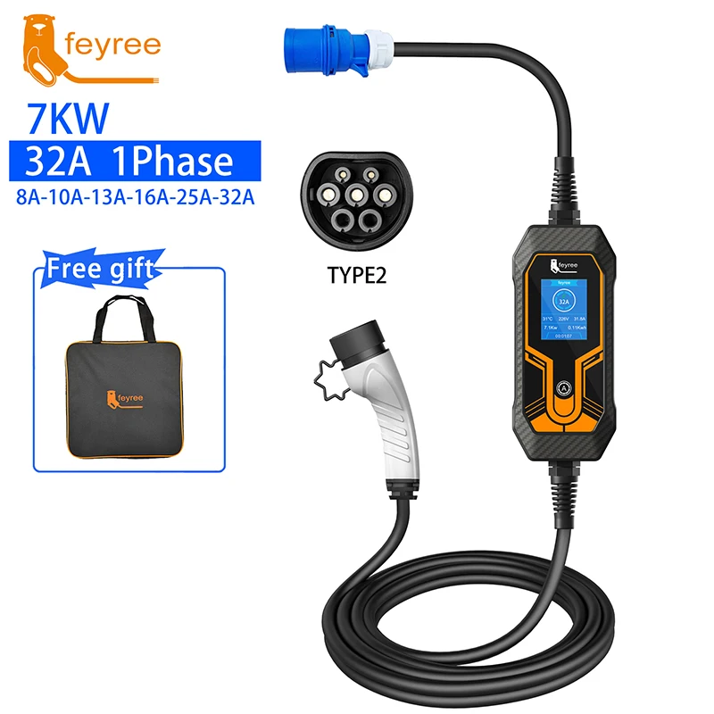

Can anyone help with this?
I've got a 32A Blue Commando 3 Pin Female outlet (to give about 7.7kW charging).
How do I find a 32A Blue Commando 3 Pin Male adapter to fit with the mobile charging connector, provided with the car?

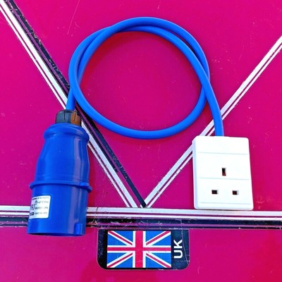

The one that comes with the car is limited to 10amps don't matter what size pulg you put on it you need one like this
That's a 16 amp fly lead won't work on a 32amp socket different sizes and the factory granny charger would still be limited to 10amps if you used a 32amp one
Edit I see you found a 32amp one now
Yeah i thought the first one was a 32amp but upon a closer look it was a 16 amp.

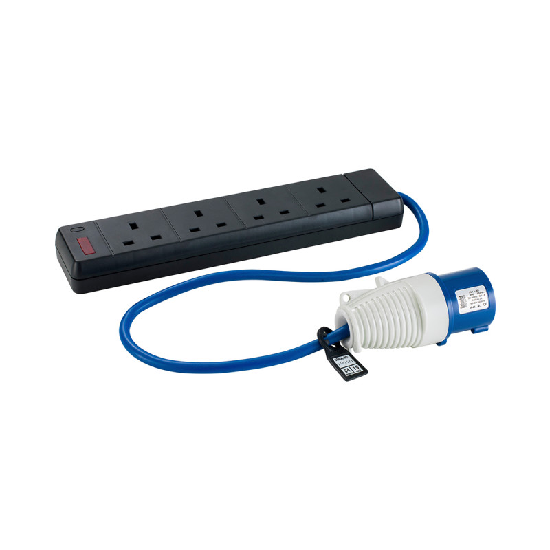

The second one i posted i would be interested in the 3 pin socket was heavier duty to take the potential 32amp feed, as the fuse wouldn't protect the female part of the 3 pin plug.
Buy the connector’s and make it yourself, it’s not difficult and you will learn something, I did and it was a lot cheaper less than a tenner👍🏼
Sorry but no no no its a 2.5mm fly lead you really want 6mm at minimum 4mm and you will never get standard 3 pin socket to run over 13 amps safely
I misspelt/autocorrected the word in, i meant if.
As in if the plug was heavier duty due to the load.
But as you state, the cable itself isn't up to scratch.
Perhaps this is better however i can't see the cable size used
The biggest problem with using a fly lead the commando plug is not fused so that bit of fly lead is only protected by the fuse bord that the 32amp socket is wired to so that bit of fly lead is not really protected not ideal for any long term use or heavy loads
Edit : the only way to make it safe would be to reduce the size of the fuse on the fuse board to match the weakest part of the circuit
Just plug one of these into the 32A socket.

Standard charge cables can be found on Amazon for around £100. That's where I got mine.
