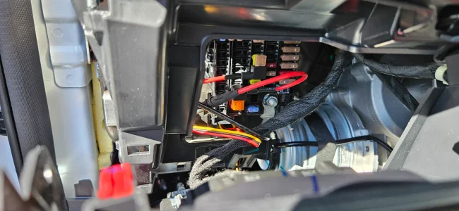

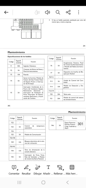

Hi, today I installed a UP03 wiring kit on my MG3 hybrid. It's not the original. I thought I was buying it, but when it arrived, I realized it wasn't. It's for a 70mai A810 camera. I plugged the ACC+ into fuse 21 and the ACC into 29. The camera works 24 hours a day, but it gets really hot. However, the transformer doesn't get hot at all. I don't know if I plugged it into the wrong fuse or if it's because of the adapter.
