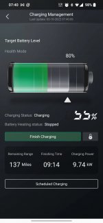

I plugged my Trophy into the work 22kW wall box this morning, I was expecting it to be limited to 7.4kW but was pleasantly surprised at the 9.74kW it charged at. Makes for a shorter charge when you're getting your juice at 2kW per hour quicker!

Interesting...does that mean Trophy at least has 11kw inverter? Given inverter losses etc. that figure seems to indicate so. When you have a moment can you check if the car socket has L2 and L3 shiny pins?

We should have either 6.6kw single phase or 11kw 3 phase charging. Losses to the actual battery are about 10 to 15% due to a number of factors including loss at the inverter. So 6.6 may only be in the 5's and 11 in the 9's..which is what you are getting.

Or it could be FUD from the App. I'd wait and see how much charge you actually get in the car - can you pop out and take a look?

My Zappi app confirmed charging at ~10kW so I'm inclined to believe it. If someone could post a pic of a heat pump in an MG4 I can check that too.

Stop doubting 😁. It is in the manual and the pins are there and the reports are exactly the charge level we’d expect!
I think the only reason people thought it wasn’t for the UK was the EU vehicle details which mentioned 11kW because that’s an expected standard on the continent but not here.
