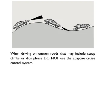

The MG user manual does warn about ACC in hills, see page 213 of etc user manual.
And as MG's are not in the same class as Audi, really hard to compare the two.
