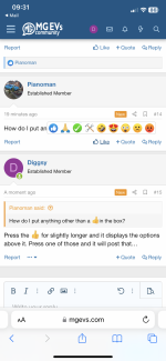

How do I put anything other than a 👍in the box?
Press the (y) for slightly longer and it displays the options above it. Press one of those and it will post that…
