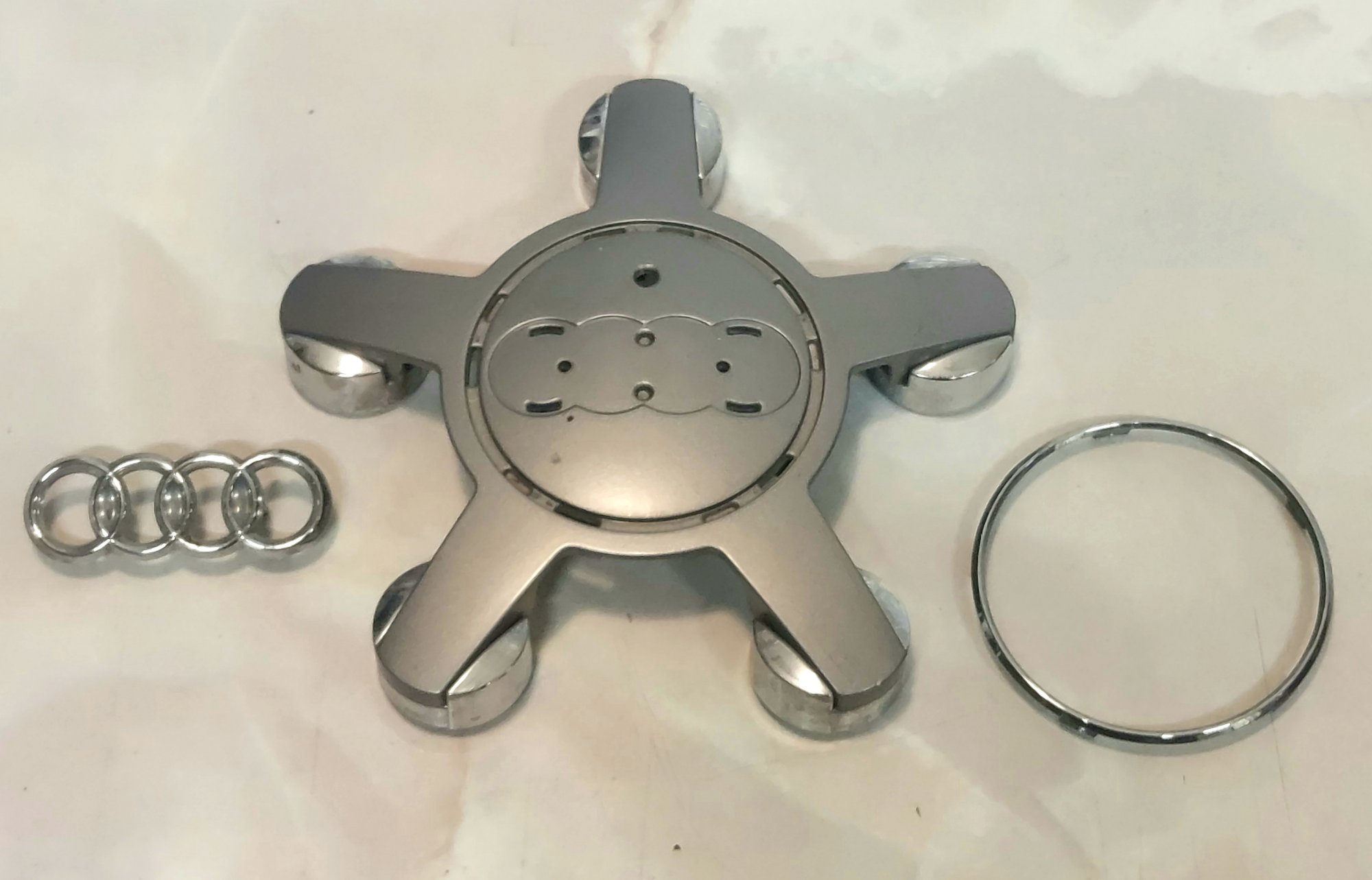

The caps have a press-out Audi emblem and chrome ring, so these were all carefully removed.

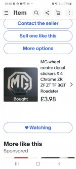

I found a chap on Ebay selling 40mm chrome MG decals, and he kindly put them on 60mm matt black discs for less than £4 including postage!
