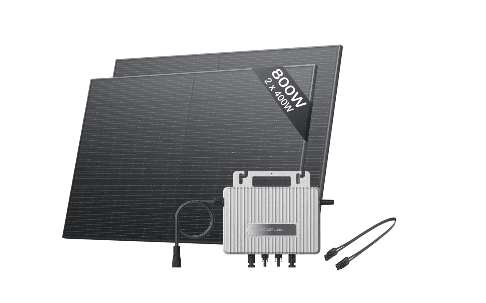

Coincidentally I watched a YT last night which showed the EcoFlow micro inverter plus 2 panels from city plumbing, total cost < £300 to give 800W max into a 13amp socket.
Was it via a plug (not legal in the UK as far as I'm aware) or did they get an electrician to connect it directly into the ring circuit?
The illegal route, I think to show how easy it would be if allowed. He said the follow up video was to show a simple battery addition to smooth the output.
As in my original post it is currently not legal but the government are looking into changing that.
You can plug them straight in and they work. The Ecoflow stream microinverter immediately cuts out if the grid supply fails.
General consensus is to buy panels elsewhere. For our house a steady 300 Watts would satisfy our needs other than boiling a kettle or cooking, which would be covered by the 1 or 2kWh battery.
Whole installation could be less than £800.

Agreed it is not legal as as stated but many are now doing this with the Ecoflow systems. Here's an example
Is the problem that you could be drawing 32amps into the ring main from the grid then adding an additional 3 from the micro inverter which would then exceed the rating of the cable but the mob wouldn't detect it?
That is my main concern, but specifically compounded by the fact that a radial circuit only needs one loose connection at one of the sockets (and I've seen that on multiple occasions) to become two radial circuits, each carrying up to 40+ Amps before any solar production is added to that, all on a single 2.5mm2 T&E cable.
There are other concerns too, such as efficacy of older (e.g. type AC) non bi-directional RCD in the user's CU and its ability to not be blinded by DC current which is likely to be generated from a micro generation unit on its load side.
Then, there's the wider issue of whether all such "consumer installable" inverters will adhere to ENA G98 compliance in terms of disconnection times and quality of generated waveforms. I guess a lot will be cheap non-compliant Chinese rubbish - let's just hope they don't start selling ones with battery storage in them as well, or we'll be seeing a lot more fires - like with cheap e-scooter chargers, not to mention adherence to the 'currently-not-mandatory' BSI PAS 63100 guidelines :(
