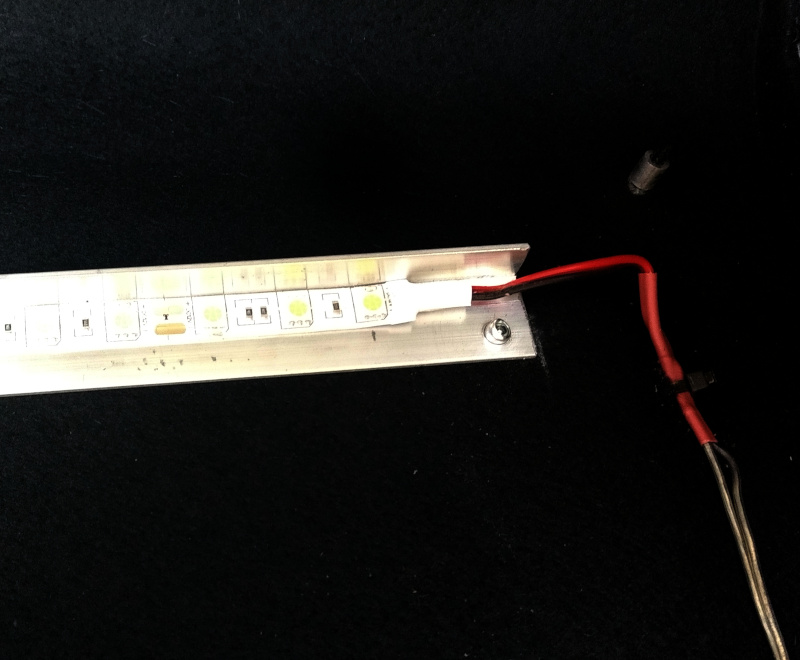

The next project was the boot. So, I used the left-over strip light and made this:
The strip light is stuck to an aluminium angle, which is pop-riveted to the parcel shelf. The angle side is facing toward the boot opening so that the LEDs are hidden, and they don't blind you.

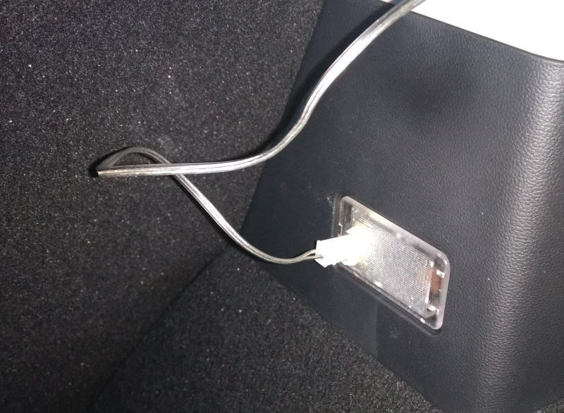

I tapped into the boot light circuit and installed a socket so that the parcel shelf can be removed if necessary:

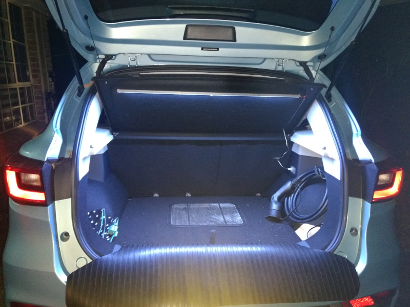

The final result looks like this:
It's like daylight!

That looks very interesting....but my parcel shelf is in and out seveat times a week, as i transport our 'family' Greyhound around. I wonder how long it would take me to rip the plug out? :oops:

Certainly will draw attention....in carparks......at night......😳
