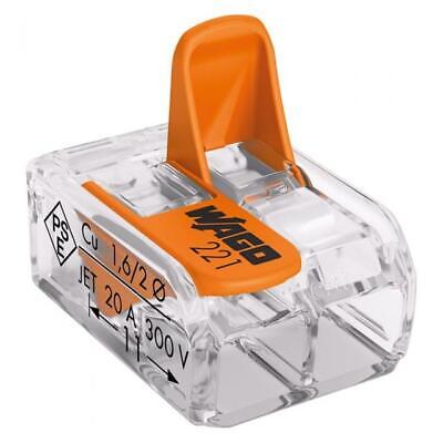

What is the best and safest way to join the cables in the junction box? The original installation had cables terminated with ferrules joined and crimped in bullet connectors. Do I use this method again or can I use block connectors with appropriate current rating?

You didn't need to cut the cable you could have just undone the cable from the pod point and reused?
You can use this instead
especially if you don't have the right crimping tool
You can use this instead View attachment 13088
Only rated to 20A a 7kW charger can draw 32A, the Erma crimp connectors are better but need to crimped correctly with an appropriate crimping tool.
