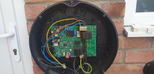

Maybe this is why the charging slowed down. Now completely dead.
Indeed. It looks like at least one of the connections was loose, became high resistance, and dropped the voltage that the on-board charger saw. Hence the drop in charge power.
So a proportion of the charge power was dropped across the resistance of that bad connection. It doesn't take a large fraction of 7 kW to start getting toasty.

@Shippo: What brand of EVSE ("charger") is this? I see the word "SPARKY" on the PCB, but the only one I can find with that name looks like a Tesla destination charger.
