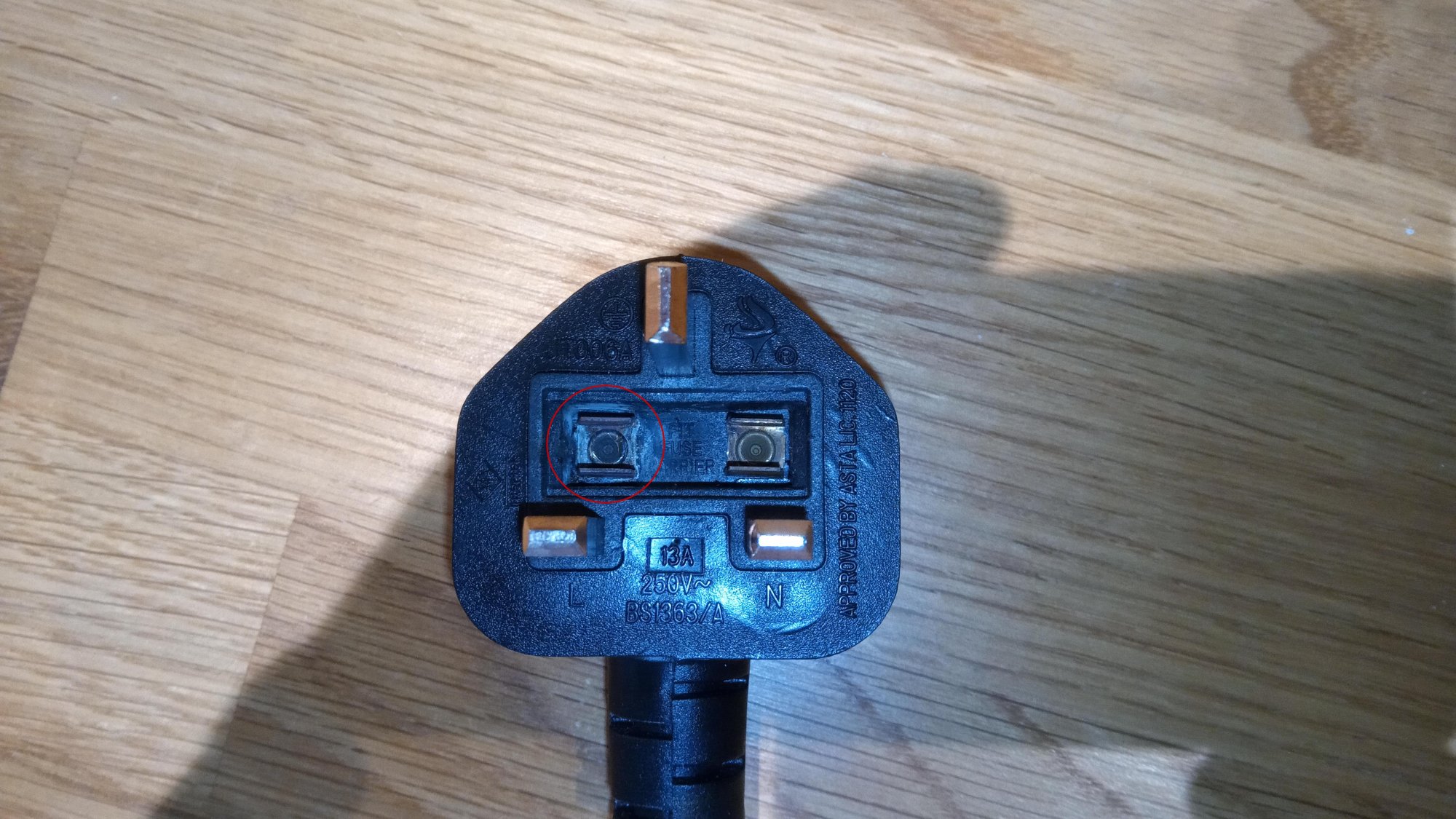

Just had a look at the plug, yep, it's the fuseholder. Phil is bang on, the crappy pressed rivet holding one end of the fuse holder contacts in the plug is loose!
I suppose I could ask for a new one under warranty, but then, that's going to have the same crappy design in the plug, so I'll probably just change the plug.

Here's the culprit, the fuse holder circled has a loose rivet causing high resistance and huge heat build up and transfer down the Live pin!
That's not good for a piece of equipment that is supposed to be able to take a continuous 9 or 10A for 12 hours. :confused:

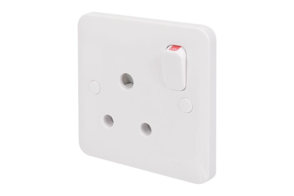

The larger 15A version of that never went away! Usually used in theatres and exhibition type places, it's superior to the 13A we have now and can maintain 15A indefinitely, not fused, so can only be used on dedicated circuits and doesn't have the child/idiot proof shutter mechanism, so can't be used in your house :)
readily available too:
