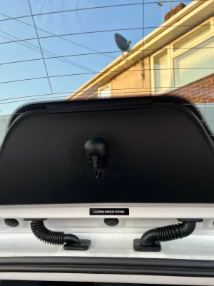

I did see someone posted quite a while ago if the aerial isn't grounded properly it can cause this issue.
There is a bolt in the rear window, someone else suggested removing this wet and dry to ensure good metal contact and it fixed their problem.

Many thanks for all the replies, I’ve resorted to the workaround of using my iPhone, selecting the DAB station I require, and then using Apple Car Play. As this works perfectly, I know that there must be something wrong with the signal in the car. I will have a look at benrb7’s suggestion regarding the earthing, or perhaps ask the dealership to check. All that do is try the radio at their location, strong signal, and say ‘nothing wrong’.

Many thanks for the suggestion, see my reply above.
