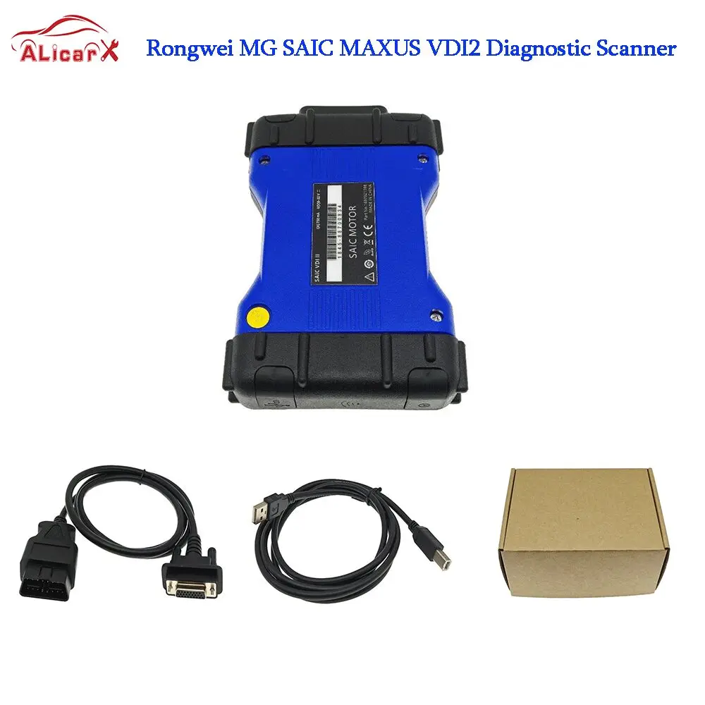

I ended up getting this
It connects fine, only got to try the sips read the car before the hour ran out, the RMI page was going slow so it took a while to download & install
If anyone else wants to get an adapter to connect to their car, let me know & I'll share the software so it's installed ready, you need an account & to buy some time to get access to a login anyway, although the VDS software says it has an offline mode I can't currently access it but it maybe available after first login
