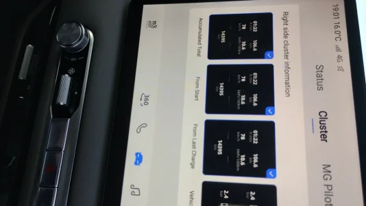

Hi, can't seem to get the since recharge, since start, accumulated mileage, on drivers Speedo screen does not seem to be on drivers screen despite trying all steering wheel buttons, really wanted to reset it all as it's also on main (left)display of car too
Also it states over 14000 kilometres on those screens, when car mileage is only 1500 miles( I know that can never be adjusted)
Any help appreciated being trying a while.
Thanks.
You need to select the ones to show on the main screen, select the car icon and it is the second tab possibly status but my memory is shattered after a hard week at work.
The button to use is the screen button to scroll though the different “cards” (middle right side) looks like a large and small window
The images on the main screen are there to allow you to select which ones you want on the driver screen.
Thank you Gus and Alb, will try and sort it in a bit but, any idea why those screens show 14000 Kms I think, when car has only done 1500 miles?? Thanks
Thanks in the hope it helps someone else in the future, still trying to get one of these like "since charge" to go on steering wheel card menu slot. Will keep trying....
