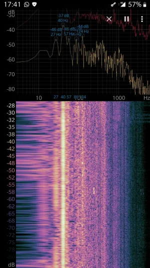

may you measure the noise with spectrum analyzing app and post screenshots here?
I have noise like this:

Any update? I get similar bass thump from rear driving over small bumps and cracks in the road. Would love to know if there is a fix
