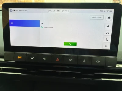

Swipe the home screen right to get the second screen and tap 'Rescue Call'. You should see the UK number 0800 072 3338. If necessary tap the 'Switch country' button.
Have just checked my UK registered MG4 Trophy and, just like other replies, I found it identified the Country as Cyprus. So I changed that to the UK and the correct 0800 number came up. Hope I never need to use it! But thank you for those who have reported their experiences here.

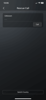

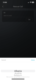

EDIT : If you click on the pics there is something there even though they just look black !!
The SE does have eCall, but there's nowhere in the car (that I can see) to set the eCall number. However ... in the app on the main menu screen, if you click the headset icon top-left that takes you to the Rescue Call page where you can set the country. With UK set then the number is indeed 0800 072 3338. :)

Thanks for clearing up my confusion. Was a lot to take in at the handover last July so I must have misunderstood the use of the overhead SOS button. The dealer didn’t set it up today but it was actually quite straightforward as there is only one number for the UK. All sorted now.
