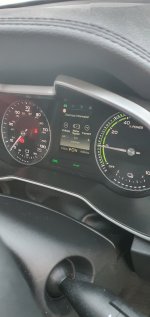

Thanks cardiff for ducking up the BMS. Not charging when unlocked, taking 5 hours to equalise and battery voltage is off (447v). The service was done on Wednesday. This is the dealership that gave the words "we dont do the HV update unless requested" when asked by a mandatory update....

So they re-appled the software for charger controller (plug) as it went out of spec. Just running a nice slow 1.4kw charge (via eco mode on zappi) advise was slower charge the better. Got to wait until tonight if battery voltage is back to normal and if equitation is either 1hr or 5hrs.... But it charges unlocked so fixed subject to further tests.

Todays Update - car reported full charged and ZERO equalisation charge. 🧐 Voltage 449v. No lights, no hvac system.
Either December '19 BMS isn't equalisating the battery correctly (I doubt), or the charge controller & the five hour equalisation completely mess things up on one charge.
Mystery continues.

I’m sorry that you’re having issues. Out of interest - how does the car report a full charge and zero equalisation?
I monitor it using Myenergi/Zappi app. When equalisation is happening it shows about 300w pull. Normally you see a period of time at the lower rate at the end of charge. Last night/this morning it went from 1.4kw to 0w with no 300w period.
