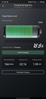

I was topping up the car last night using the granny charger included with car, and I was able to get 20% during my cheaper 5 hour tariff with Octopus, and what I saw on the app is that it was pulling on average 1.95kwh to charge car, but on my IHD I could see 2.4kwh~ being used on top of my normal usage. I think at the end I saw like 2.06kwh being shown on the app. Either way it finished before my higher rate came on.
