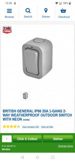

I love the mini shed.
Could you mount something like this on the side
