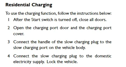

just for my reference, what should be the correct order?
Found it! looks like i am not following 3 and 4 correctly
