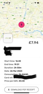

I cannot charge at home. I use public chargers. Being charged by the hours seems a rip off.
This was my last charge which was almost 3 hours and at about 9.8 kWh.MG5 FL Trophy has an onboard 11 kWh charger.
