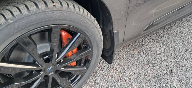

Installed these today, front and rear. Good fitment. Very easy to install! Does not ruin the looks of the car, and I think they look as they could have been IM original parts. Got them from AliExpress for cheap. Nokian Hakkapeliitta 10 EV nordic studded winter tyres.

I did attach them without removing the tires. I did not jack up the car either. Just a short stubby philips 2 screwdriver. Used the original hardware and mounting holes that was on these spots on the car. 3 attachments on each mud flap, and in the front there were a bolt behind the mud flap, not screws/clips as in all the other places. In front I just turned the wheels to get good access. Very easy.
Front mud flap: Clips on top. Philips screw at bottom. Bolt behind mud flap
Rear mud flap: Two philips screws at wheel side, and one philips screw behind mud flap.

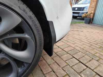

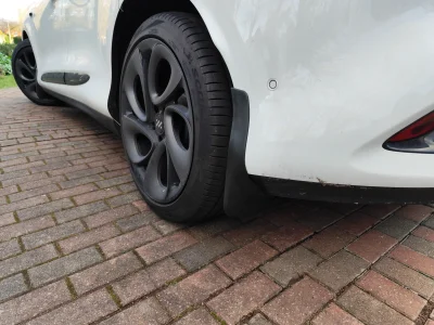

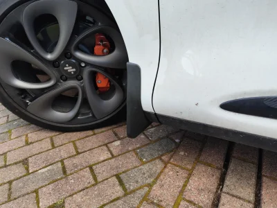

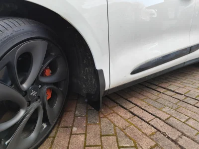

Good morning and Happy new year!
No need to remove tyres or anything.
There are three screws for each wheel. Two on the back of the wheel arch and one at the bottom.
Unscrew, put the mudguards in place and screw back. Done.
