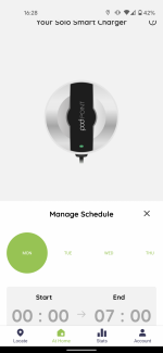

Yep, received the link this afternoon.
Great - that’s good to know. Can you keep us updated how you get on please?
