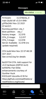

I have an MG ZS EV 2021. I have updated to 3.2.0.18 from 3.2.0.17 last weekend and experienced no problem whatsoever.
