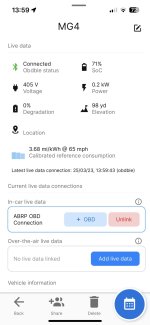

I got the vLinker MC+ OBD2 dongle now and no issues experienced with the car.
This model should power save when stopped then turn on again with the car. My older dongle couldn’t auto power on with the MG4.
ABRP are still updating the MG4 LR/Trophy profiles (as SOC % was 3-4% off due to the maths) CORRECTION this appears fixed now. See screenshot from today.
Connection is stable and reports fast yet this is more down to your choice in dongle. Not the car. Cheap eBay ones should be avoided.
It can’t help know if a charger is busy or offline - it only sends car data to the app.
Yet it allows accurate numbers for range/usage estimates as knows what the car has left in real time, power draw and real world average consumption by you. After taking the pic I’ve reset the consumption in ABRP to start an accurate measure.
Limited yet essential values for range calc are live - SoC %, distance, voltage, power draw and elevation. Hopefully more too follow.

Depending if the charger shared the information or not, ABRP would know which charger is offline / busy / free.. It even have statistics information about how busy a charger is at a given time..
