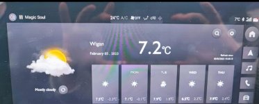

Basic question always: is the car online? Easiest test: do the weather services work?
Yes weather info there and up to date. I do however have a message notification top right which I haven't had before. No message evident!
It should appear in the "User" menu -> "Messages".
If the weather is there, the car is online. The iSMART app locked me out a week ago just to work perfectly well again the next day. I'd wait 24 hours and then take it to the dealer. It seems to be a fragile system.
