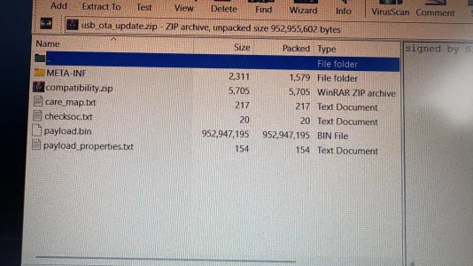

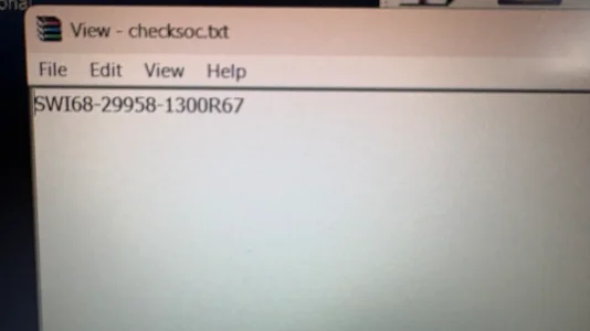

Amongst many folders (mostly empty) is ‘usb_ota_update.zip’ which contains txt file showing SWI68-29958-1300R67
Is this what everyone’s looking for?

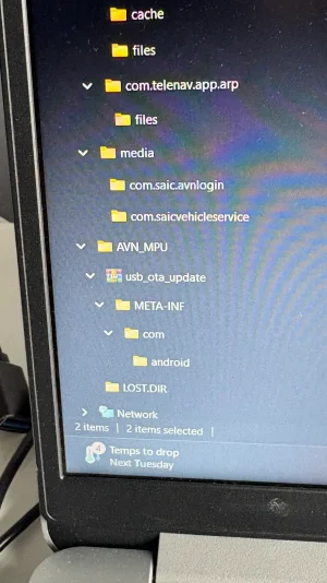

Worked for me! Nice one. Usually the root structure is like this though:
The uploaded file just looks like the file that is found within the AVN_MPU folder.
If you have these on the drive and could upload these too that'd be great.
I'm sure others would be interested in all the files on the USB at some point as there may be other new files also.

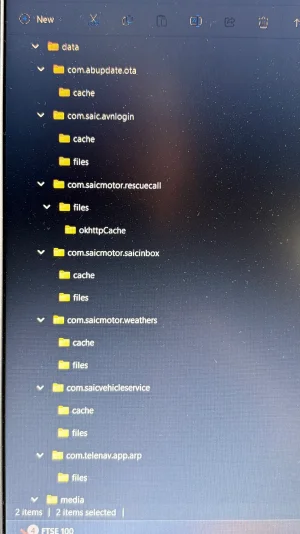

This is the folder structure (slight overlap on pics)
Almost all folders are empty and Dropbox ignores their upload.

Do you have the md5_check.txt and vipimage.bin files in the root?
No, those files aren’t anywhere on the drive. If you look in the extracted folder, under ‘META-INF > com > Android there are two files, ‘metadata’ and ‘otacert’ which may be the equivalent of md5 and vipimage?
Actually it looks as if those files are the same in every release or at least R46, R59 and R63, so we should just be able to use the previous file if necessary
