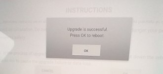

I updated the maps in my Trophy (R33) today. After hours downloading and extracting, the data needed about 40 minutes to update the maps. I was concerned after I plugged in the USB drive to view greyed-out text asking me to select a resource in a window with a lit Cancel button but it came good in the end without intervention. I attach a series of images from the sequence.
