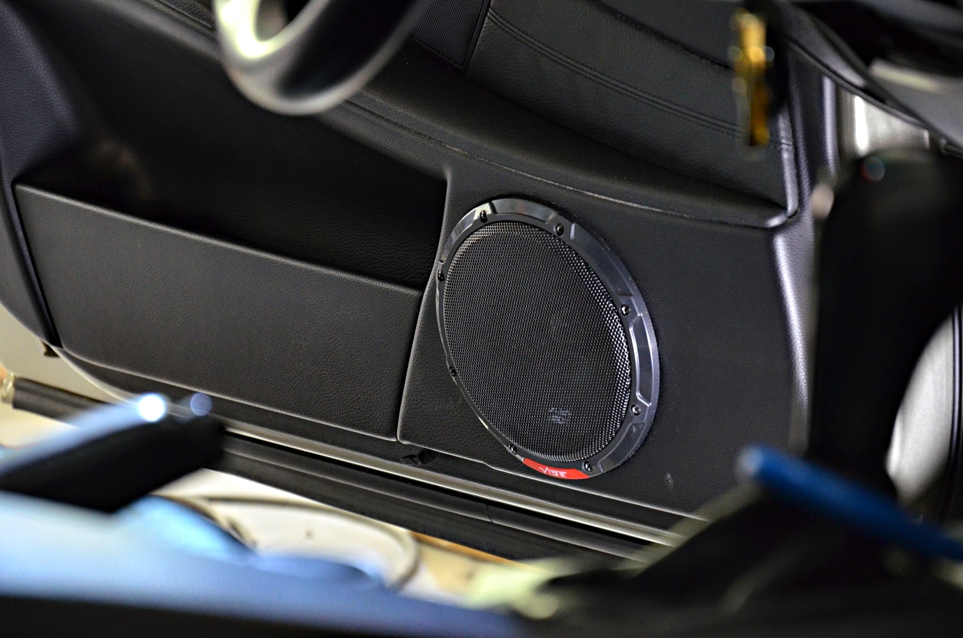

Upgraded the front and rear speakers with Vibe Slick6-V7 6.5 component fronts and coaxial rears. I used the original speaker mounts modified to fit the new ones, you can use aftermarket spacers they need to be 34mm deep. The tweeters need the crossover to work properly. The tweeters made a big difference to vocals, horns and percussion lifting the highs to a much better place. Just replacing these is a big improvement.
There have been reports that the rears only get a low pass feed but I haven't found that after some frequency testing, they are getting the full range.
The mid and bass is much better with good low end control and nice bass note definition.
I chose the Vibe speakers as they are easy for the stock head-unit to drive and will be ok for a future amp upgrade also.
The sound deadening is important and makes a big difference pulling the sound together cleanly. It doesn't need to be foil backed as I've used, I already had a roll of foil backed left over from insulating my sail boat (which I converted to electric drive!).
The wiring colours I suggest here are what my car has but should be the same so please double check with a volt metre for the + and - terminals to be sure.
The amp/head-unit is behind the glovebox and you can gain access to it by removing the glovebox, this is not needed for this upgrade, but may be useful if you want to add an amplifier so you can use the existing speaker wires.
Vibe Speakers

Thanks for the info @Alansurfer! On your recommendation I went and bought the same speakers from Amazon (they’re cheaper there than directly with Vibe, even with the 15% store wide discount). So far I’ve modified the tweeters and installed them, going to wait for better weather to pull apart the doors.
TDLR: The tweeters make all the difference in the world! The sound stage is amazing now, vocals and hi-hats are sharp and crisp and the stereo field is VASTLY improved! If you could do one thing to improve the audio in the MG4 it would be the tweeters that’s for sure!!!
I ripped apart the old tweeter and epoxied in the Vibe ones to the original driver holder, I also removed the housing of the Vibe cross over and stuck the PCB directly to the back of the tweeter. I also re-soldered all the cables on the back of the tweeter to get rid of the excess, removed the woofer cable completely and soldered the original connector back to them after removing the excess plastic from the original tweeter connector. It all makes for a tidy install and no hacking of the cars loom what so ever.
Really looking forward to completing the process and also the dynamat as I’m sure that’s going to make another huge difference too.

I like your idea for utilising the original connector and soldering on the crossover. I have just bought the same speakers for my wife's MG4....did you also remove the housing from the actual tweeter itself alongside the crossover or does the tweeter fit in the original driver holding with the housing intact?
It does fit nicely as both the old and new drivers are pretty much the same size. However the clips that hold the old drive in are not the same so to secure the new tweeter I’d recommend epoxy resin on the sides. I wouldn’t recommend hot glue as the dash, in summer, would easily get hot enough to melt it.
I secured the crossover to the back of the tweeter using the circular doubled sided foam pad the speakers came with but in hindsight I’d desolder the cap from it and glue that directly to the back then used the rest of the crossover in the door. The woofer works fine without it but, to me, it would make more sense (now) to use the woofer component of the crossover with the woofer.
Hope that helps!
