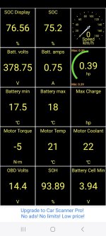

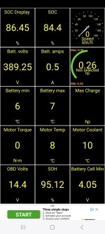

These are two pictures showing SOH from yesterday 95% and August 93%.
How has the SOH improved?

Who knows what updates they have done trying to sort my Radio Module Disconnected fault.
Did you do a battery calibration recently (from SoC below 10% fully AC charge and balance)?
Both NMC and LFP batteries need balancing periodically to get best performance.
I don't think that is for NMC.
AFAIK, every EV make has some sort of battery calibration procedure, regardless of the cell chemistry.
There is even some cryptic entry under HV battery maintenance in the MG5 manual
Battery calibration and cell balancing are two separate procedures.
I do try and battery balance monthly.
