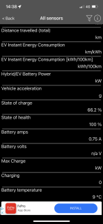

Got my NEXAS NexLink Bluetooth 5.0 OBDII Scanner - using Car Scanner on iOS showed battery SOC and SOH but wouldn't initialise through ABRP. Next option is to either acquire an Android phone (Nokia G10 is £100 and should have several years updates) and try torque. Or accept the limitations of the car.
