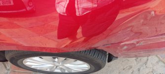

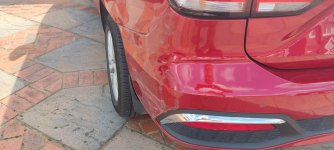

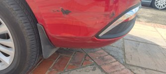

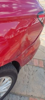

I have a red tri-coat and managed quite a large area of minor damage on the n/s rear corner which required repainting. The repair did go up £50 (to £650) when he noticed the tri-coat but certainly to my untrained eye you can't tell the difference.
I had similar damage to mine, in the red paint and had the repair done on my drive for around £300, I think. If you are going to use a mobile repairer, communicating the paint code from the driver's door sticker will save delay as it's a special order for most...
but they had no problems colour matching and you can't see any evidence of the damage...
