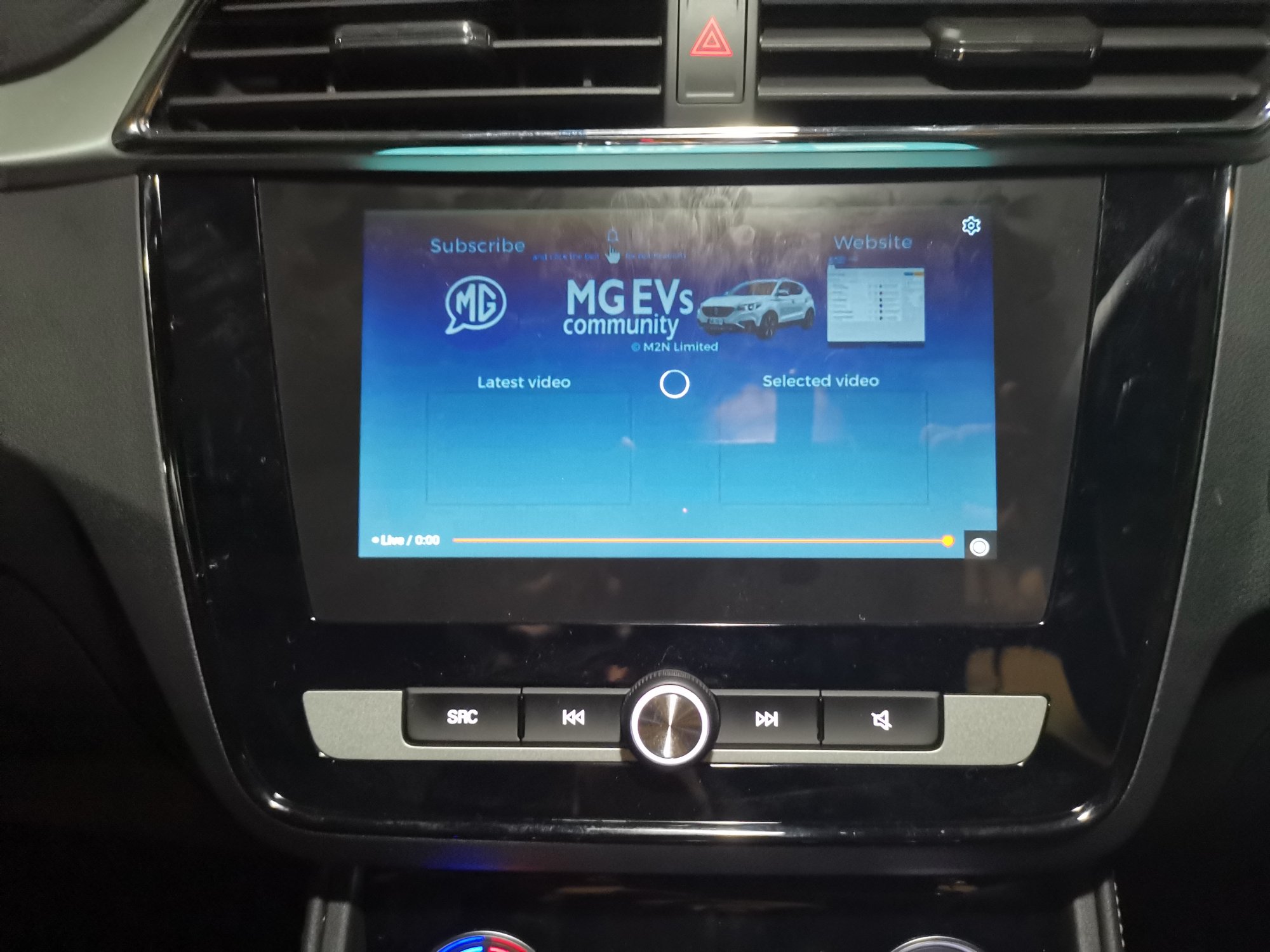

... watching podcast from the infotainment head unit.
Or anything else from YouTube to netflix.
From internet browsing to using your zapmap/ABRP or any other mobile app.
Watch any video that phone can play..not restricted by stock infortainment codecs only.
All possible.
Edit
Jump to detailed video post
Still testing it. Not quite polished enough.
HEVC playing at FHD even with subtitles
Nice feature!! Is this wired or wireless mirroring?
Its wired. For wireless need extra hardware.
I can remove the status bar (which would remove the indication thats it's mirroring) but I prefer the information it shows.
Did you try it already?
Haven't tried it!! Where did you buy the hardware for mirroring?
