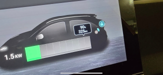

R63 charging limit stuck at 90%.

Anyone else having this issue?

I thought the limit could be altered via the app, even though the slider was missing in the car? (I'm pretty sure there's a software update to fix that issue - I think some configuration needs to be applied via SIPS).

The app doesn't let me choose after this update.
When R63 is installed, it must be configured via SIPS, dealer should have done it during upgrade process. Your bug is symptom that it has not been done.
