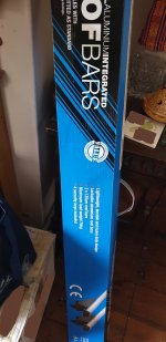

Well, I probably got your returned 1.35 Summit bars! They had been opened before I got them.
