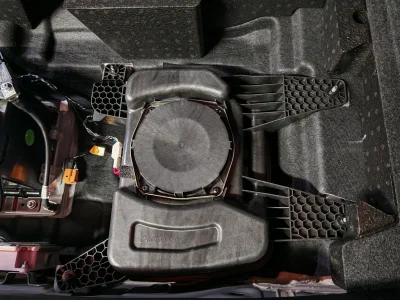

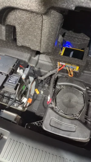

Regarding the sub, I have attached a couple of pictures (it is under the styrofoam).
Excellent! Wow, there's actually a lot of space! At least enough to build something A LOT better than that plastic abomination of a pretend subwoofer!

From the pictures, it looks pretty straightforward. Seems to be a decent size space if one rips out the original sub, and it should be possible to find a box that fits. Difficult to judge the size from the pictures, but there seems to be enough space for a 15-20 litre box, which is enough for a decent sub that gives a hell of a lot more "ompf". One should be able to source the signal without cutting or removing anything of the original wires. I'm also in contact with a company that makes custom made upgrades to virtually every car. They said they haven't had much demand for the MGS6 yet, but it's on their list. But as I said, they already have kits and wire harnesses for the MGS5, and this looks very similar.
I'm also thinking there is yet another option, and that is to actually add a strip of styrofoam or similar around the edge of the entire boot, and raise the floor slightly. This would give the option to add a slim but wide box, pushed right up against the seats, like the custom solution for the mgs5. This would also leave some storage space under the boot lid.

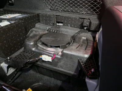

@Micropop given you know this whole audio thing (if not that there are additional settings screens 😜), looking at the wiring into the oe subwoofer, what would you say are the feeds? Is it amplified?
Ta.
Not quite sure, but since there are only 2 colors I think it's passive and that it's regular speaker wire coming from a power amp somewhere. Might be a double voice coil subwoofer (hence 4 wires instead of 2).
Or it could be that they didn't bother with different colors, and it's power, ground, remote signal (to power it on) and audio signal.
Would have to measure it to see if one of them has 12v.
