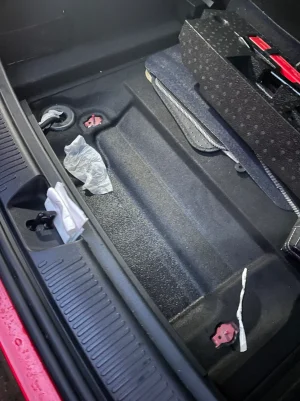

Plus recently discovered the boot has been waterlogged ! In the summer was told the rear seatbelt is wet. Now I know why!
