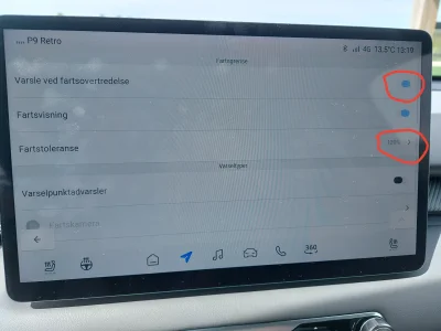

Received my MGS5 luxury long range today. First problem was that the speed recognition was impossible to turn off. The options could be removed but the warnings continued. Will contact my MG dealer tomorrow. Has anyone else had such errors so early?
I just update my own posting: The "problem" is solved. I got info from a local fb group that these warnings must be turned off 2 places, navigation AND mg pilot. I did not know about the navigation place...
Does it stay turned off if you disable it from the Navigation page?
Yes i does stay off. In the attached pic there is two options, the upper turns the voice off, the option below (120%) turns the voice off until you drive 20% above the speed limit.

Hi,
Are you referring to the repeated overspeed announcements, for example "the speed limit is 40 miles per hour" in my UK version.
The message was repeated about once every km, and was driving me nuts.
I finally delved into MG's navigation menu, then Settings, Alarms, and cancelled them that way.
Now I enjoy blissful silence when I'm marginally over the speed limit.
I hope this works for you, too.

Thanks for your answer but i think i have this sorted out. You can see the older posting in this tread.
