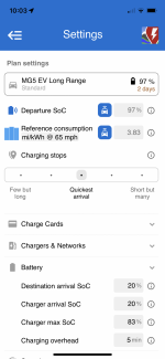

There is frequently discussion here on ekeing out range at the expense of speed. Over a long mainly motorway journey I wondered how much difference it would make.
As it's impossible to do the same journey twice in identical conditions, I plotted a route from my home town to Edinburgh using everyones favourite planning guide, ABRP, varying only the speed parameter. The table below shows the result.
For each speed the Departure SoC assumption was 90% and I didn't have live traffic turned on, or any of the other features which could impact the outcome.
So the time isn't massively different - 20 minutes quicker at 75mph v. 65mph, but you could easily lose that advantage in a minor traffic jam.
I think 75mph uses roughly 16% more charge than 65mph. Which on the new fangled Tesla chargers would equate to about £6 extra, if my sums are right. on the same assumption the whole journey would be about £54 at 65 mph and £60 at 75mph. (Yes there are savings to be made, eg. start at 100%, charge at cheaper places, but this is really a comparison of speed v. range rather than a costing exercise).
Someone has posted elsewhere that 65mph is can be a somewhat awkward speed on the motorways, my own view is simply that I like to feel I am "making more progress" than it feels like I'm making at 65 mph.
I realise this isn't scientific and that folks will find plenty of flaws in the logic but it's the only way I could think of comparing. I guess also a different route may give a different outcome but I'm not that familiar with ABRP and I couldn't find the settings data to reset the mileage if the departure point wasn't my current location (though admittedly I didn't try too hard!!). Obviously non-motorway routes don't have the same scope for varying your speed, nor would they often enable fairly constant maintenance of a speed.
Anyway, here it is, enjoy!! :)

I'm afraid to say that ABRP is NOT my favourite planning guide/tool. It's range for the MG5 seems to make no sense to me when I have tried to plan journeys. This can be seen in a recent post where it predicted a SOC fall from 100% to 19% after travelling just 124 miles, this for a LR.

Yeah - I think ZapMap is better in so many respects but now that ABRP slowly calibrating to my driving based on OBD readings, I'm hoping to see more accuracy when using with realtime data soon.

Haha well this exercise was the first time I'd used ABRP. I had the impression people here liked it but it didn't grab me when I first loaded it.
As I've previously said, I rarely have to charge away from home anyway but I do have a trip to Edinburgh in August and as a bit surprised how short some of the legs were, Also I think I want to arrive with more than 10% left.

It's not very intuitive - but there are sliders for longer legs / more stops as well as setting a value for desired SOC per leg. I usually set max charge to 83% and arrival SOC at 20%. It's fine once used to it but overall design doesn't feel well thought out.
I guess I was a bit lazy in not spending time familiarising myself with the app a bit :) more, and maybe I'll do the exercise again with some more tweaking - but essentially I think it has given me some idea of the impact of speed on economy, which was what I'd hoped to achieve.
