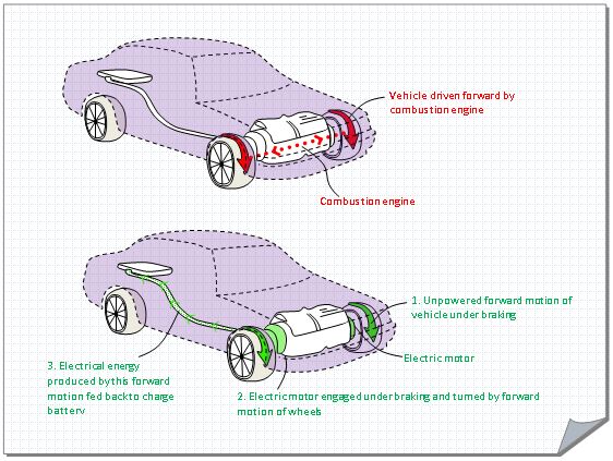

What is a hybrid?​
Commonly called hybrid electric vehicles (HEV), as the definition above suggests, a hybrid car is simply one that relies on two different power sources for motion. The two different power sources are typically petrol and electricity (most common in the US) and diesel and electricity (which can be found in Europe).
There are three main types of hybrid vehicle; full hybrids, mild hybrids and plug-in hybrids.
  • A full hybrid (FHEV) can run on just the combustion engine (i.e. diesel/petrol), the electric engine (i.e. power from batteries), or a combination. The Toyota Prius is the most commonly known example of this. A full hybrid is not plugged in to recharge; the battery is recharged by running the combustion engine.
  • A mild hybrid has an electric motor and combustion engine which always work together. An example of this is the Honda Accord Hybrid. Mild hybrids cannot run in just electric or just combustion engine mode; the engines/motors always work in parallel.
  • A plug-in hybrid (PHEV), as the name suggests, requires plugging into the mains in order to fully recharge its battery. PHEVs can be run in just electric mode.
The technology involved​
The three types of hybrid all share features in order to work. The goal of a hybrid is to use the electric portion of the drivetrain as much as possible without compromising performance. Harmful emissions are reduced and the fuel efficiency of the car increases. This is because the electric motor is more efficient than a combustion engine and produces no emissions.
An exception to such a goal may be the La Ferrari, McLaren P1 and Porsche 918. These high performance cars use their electric motors to maximise performance, rather than maximise their efficiency and eco-friendliness.
“We wanted to use the hybrid technology to boost performances, like in F1, rather than use it just to reduce fuel consumption and emissions”
Roberto Fedeli, Ferrari’s technical director
As mentioned above, to power the electric portion of a hybrid engine, a hybrid vehicle must carry a battery. The size of the battery varies depending on how much the vehicle is designed to depend on it, and the way in which the battery is recharged depends on the size of the battery.
For example, a plug-in hybrid can partially recharge whilst a car is being driven but usually needs to be plugged into the mains in order to fully recharge its large battery. It is not efficient for the combustion engine to fully recharge the battery on the go.
The smaller batteries in full and mild hybrids can be recharged in a number of different ways:
Regenerative Braking
Without such a system this kinetic energy would be lost – mainly in the form of heat as the brake pads of the car heat up due to friction of the brake pad on the brake disc.
Yes, it appears that you are right the engine can charge the battery but and a big but, it will only keep it very slightly charged as the ICE component of the Hybrid is just not capable of providing enough charge to fully charge it in an efficient way. It must be plugged in to an external source to make any sense.
The camping guy who is thinking of buying an PHEV does not have the driving requirements to make a PHEV viable in my opinion.
It would be interesting to find out how long one would have to drive in ICE mode only to actually charge the battery to full, I would think it is NOT financially viable in any way but I could be wrong!!
Regards
Frank
