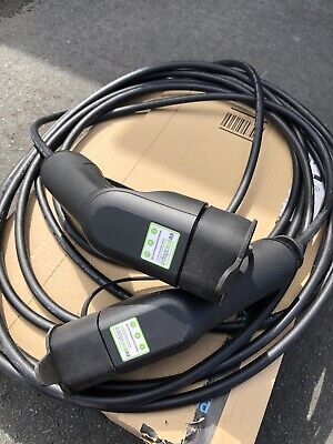

I’m sure this has been discussed many a time, however I am unable to find a exact answer. My ZS came with a Granny charger and I’m looking to get a type 2 to type 2 cable. What would the community recommend as the prices seem to be all over the place, and would buying one second hand be worth it or not?

I would get a higher rated one than this one. Most home chargers are 32amps now which is 7kw. This 16a one would get rather hot or even burn out if you tried to charge at 32a. Be careful.
Sorry the one I h got was 32a I did not notice this one was 16a the same type and price
