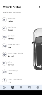

I was checking the status of my Trophy's tyres after receiving a low pressure reading of 2.3bar on a cold day which I ignored and it went away when I drove this car. However, today, I got the status, with a normal statement about type pressures, see photo 1:

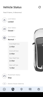

But when I checked I found as per photo 2:
I checked with my gauge and yes it was at 1.6bar and there was a screw in the outside raised tread. Repair will have to wait until after Christmas.
I had no alarms and, obviously, the car thinks 1.6bar is ok but 2.3bar is not. Strange software, probably using 'equals' rather then 'less than' in the detection routine.
