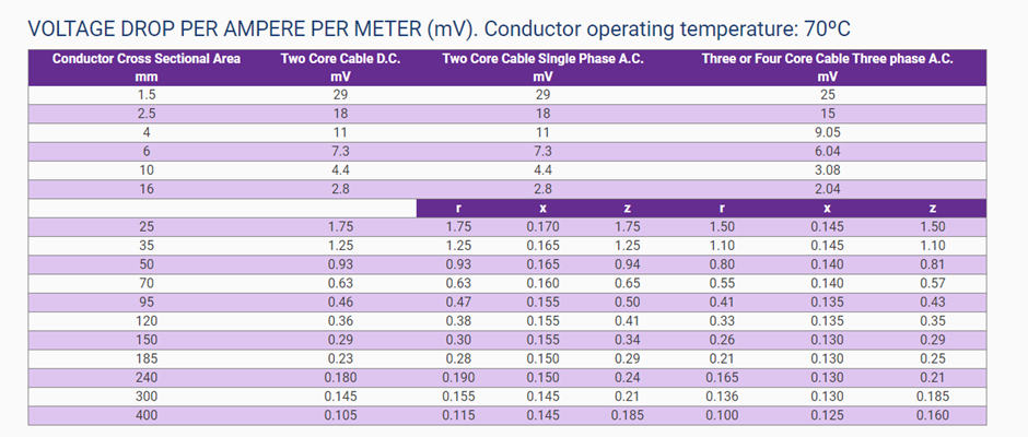

Came across this, doesn't answer the question but I was curious about losses in longer cables, so if you are interested in that, read more here:
I don't think anyone was contending that 10m was an issue, just that there will be proportionally higher transmission losses with a longer cable.
The longer the cable the larger the diameter to cover the lose ie 6mm on short runs but 10mm on longer runs.
