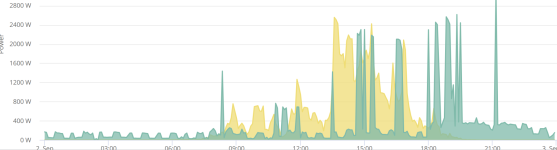

We have an end terrace house
A Summer day when we were away on holiday: 2.6kWh used.
You can see the blips when the fridge/freezer comes on. Goes from 30W to 130W during those times.
Yesterday I was in and we had the oven on a lot in the evening: 9kWh used.
Is this what you had in mind?

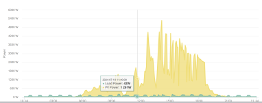

This was this usage on one if the days while we were on holiday in Scotland
That's exactly what I was looking for, thank you.
I think the blips are the freezer rather than the fridge, because during the morning when I had my faulty fridge removed and replaced with a new one (which wasn't to be switched on for four hours after installation to let the coolant settle) the blips went on as usual. One blip every half hour. When I got the new fridge installed my impression was that the base load of the house went down a bit.
This is a day when I was on holiday, with only the house load showing.
It actually looks less than that second graph you posted. But then in your earlier post you said it was varying between 30 and 130 watts? But your graph shows it varying between about 150 and 300 watts? Mine seems to vary between about 120 and 210 watts, which doesn't seem ureasonable.

Yes, seemingly yourself and Jomarkh have a higher baseload than me.
I guess our standby devices don't use much. I don't know if the inverter is "self-powering" according to this calculation, and what other than the router and the radios/fridge-freezer in standby will have any draw. We don't have a TV.

Oh, sorry, that was @Jomarkh, not you, which is why I was confused. Mea culpa.
