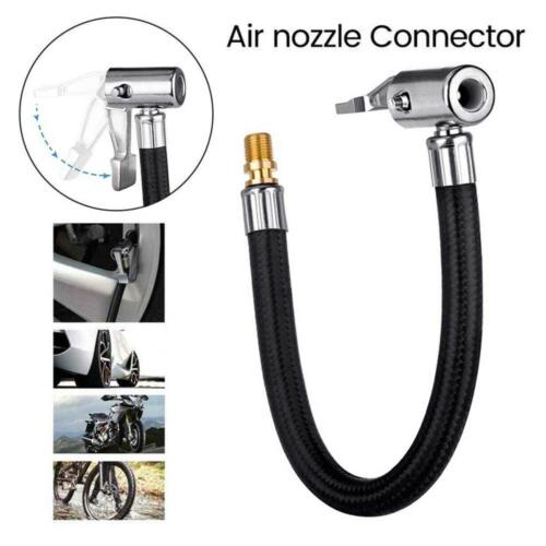

I got these off Amazon just in case I need to inflate tyres

I had the same m issue and ended up getting one of these it works a treat and is now permanently connected to air pump.

Only get good extenders as cheap ones leak.
