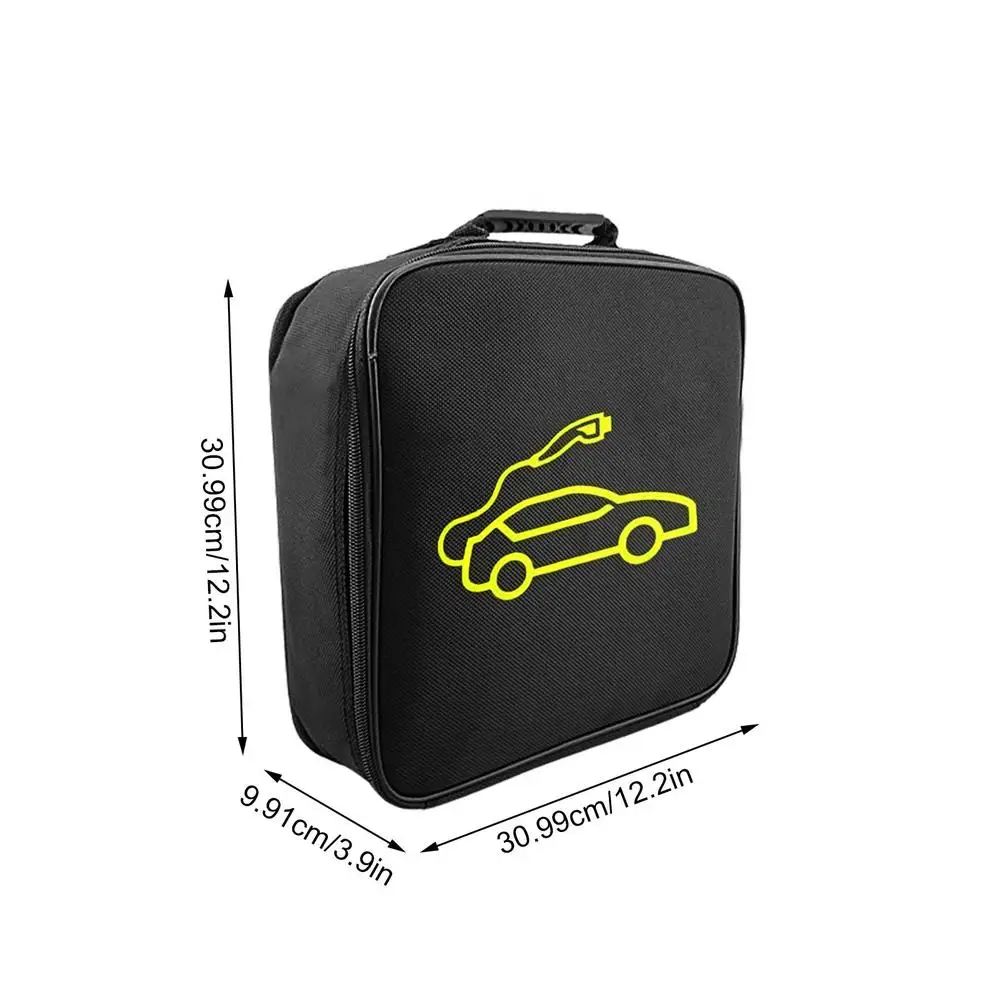

Hi yeh I think you could be dead right there is a difference some how as on my MK1 mg5 I had no problem in getting the T2 cable and it bag under the bonnet often did that when the boot was load with luggage but now I have got the Face lifted MK2 mg5 there does not appear to be has not as much clearance between the motor cover and the under side of the bonnet also under the bonnet is now lined with a sound deadening pad I think it is so I’m not sure I can do that with the cable in the bag any more but there should be enough space if I take the cable out of the bag and perhaps wind it around the motor cover and maybe touch the plugs down somewhere I could be wrong not try as yet.looking at them picture on the French site maybe they have removed the frame from under the cover I think it’s only there the support the motor cover in the first place but again I could be wrong
