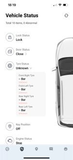

Anyone had a TPMS fault pop up on their Facelift?
Raining so not had a chance to check tyre pressure but at a glance they look ok.
Also anyone know if there is a way to reset/clear this through the info system?
I tried a reboot holding home button for 10 seconds.
Have tried powering the car off and back on.
Not had any wheels change or anything wheel related.
Next step is to check tyre pressures are right. But seems unluckily cause as all not registering.
Last resort would be disconnect the 12v. Before calling dealer.

Also funny how the app considers tyre pressure unknown as normal rather than abnormal. lol

Quick update I spoke to the dealer. I had it in the shop the other day for some software update which required the car to power down which they think resulted in the TPM loosing communication with sensors. They say the TPMS probably needs to run through relearn process. I am waiting for day to take it back so they can do this.
I thought the process for this was simply to drive the car for a short time/a few miles, rather than requiring dealer intervention?
Funny enough I did ask they said the driving relearn works for things like switching wheels around.
I have driven ~50 miles so far and not fixed itself.
I don't mind going to the dealer there is a brilliant greasy spoon next door which does a great full English breakfast.

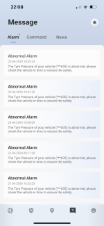

Hi, is this the sort of problem you are talking about? Bought in australia what is called MG4 Longrange 77 late last year, as seen above get persistent messages squawked at me. Had MG roadside check , tyre pressures OK. Coincidently booked in for service today, only taken a month to get in, will report back.
Close, mine didn’t mention a certain tyre.
