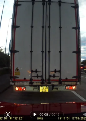

Ok guys, thank you everyone for your replies. Now i understand that there is nothing wrong with DRLs, it is a safety feature. I was in Regen 3 mode, i was coming to a stop behind the lorry without touching brake pedal, the car was gradually slowing down itself, you can see it on Dashcam speed. Only the last second i touched brake pedal to stop completely. Possibly the car didn't like that i am coming to a something big in front of me and i am not touching the brakes. I would say it is a bit strange way of warning. Am sure the lorry driver didn't notice it. Even if he did, he wouldn't have time to react to it 🙄

Hello Clive, thank you fo your reply. Yes i think it might be the same. Can this feature be turned off? Flashing lights might be misleading for other drivers.
Hi
You where traveling too fast and close to the vehicle and the car had not seen you brake so it did for you to stop you going in to the back of vehicle in front. Do not turn this off will save your insurance, first time you experience this you are uncertain what is happening, I had a few cars pull in front of me over time and this has saved me.
